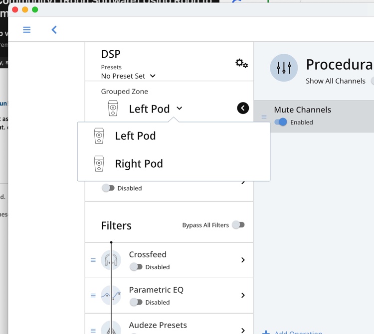

I would love to try that as well. can you perhaps give some more details on the “Procedural EQ” part? i am still confused regarding that. do i do that for the grouped pair or per speaker? and how exactly are the steps preformed?

So, in the zone selection strip on the right hand side you will start off with the home pods visible individually - you have to “enable” both in the audio section of settings first. Having selected one of the Home pods, then click on Group Zones at top right. That should enable you to select both Left and right with ticks. You see my Apple TV there too, but I left that unticked. Then save. This create the group pair for the Home Pods. Now when you click on the group you get the DSP button at the top, click on this - more pics to follow.
In the DSP window, select Procedural EQ, enable Mute Channels and then mute the relevant channel for each Home Pod - You can select each in the group by clicking on “Left Pod” as shown. Now they should play stereo. I suspect you need a good wifi signal to avoid any sync issues. I use Devolo Magic Wifi plugs and there is one between the pods which also connects the TV, and Sky Multiroom box. I think it sounds great! Hope that helps and let me know if you run into any problems.

that works flawlessly! thx for taking the time to explain it
