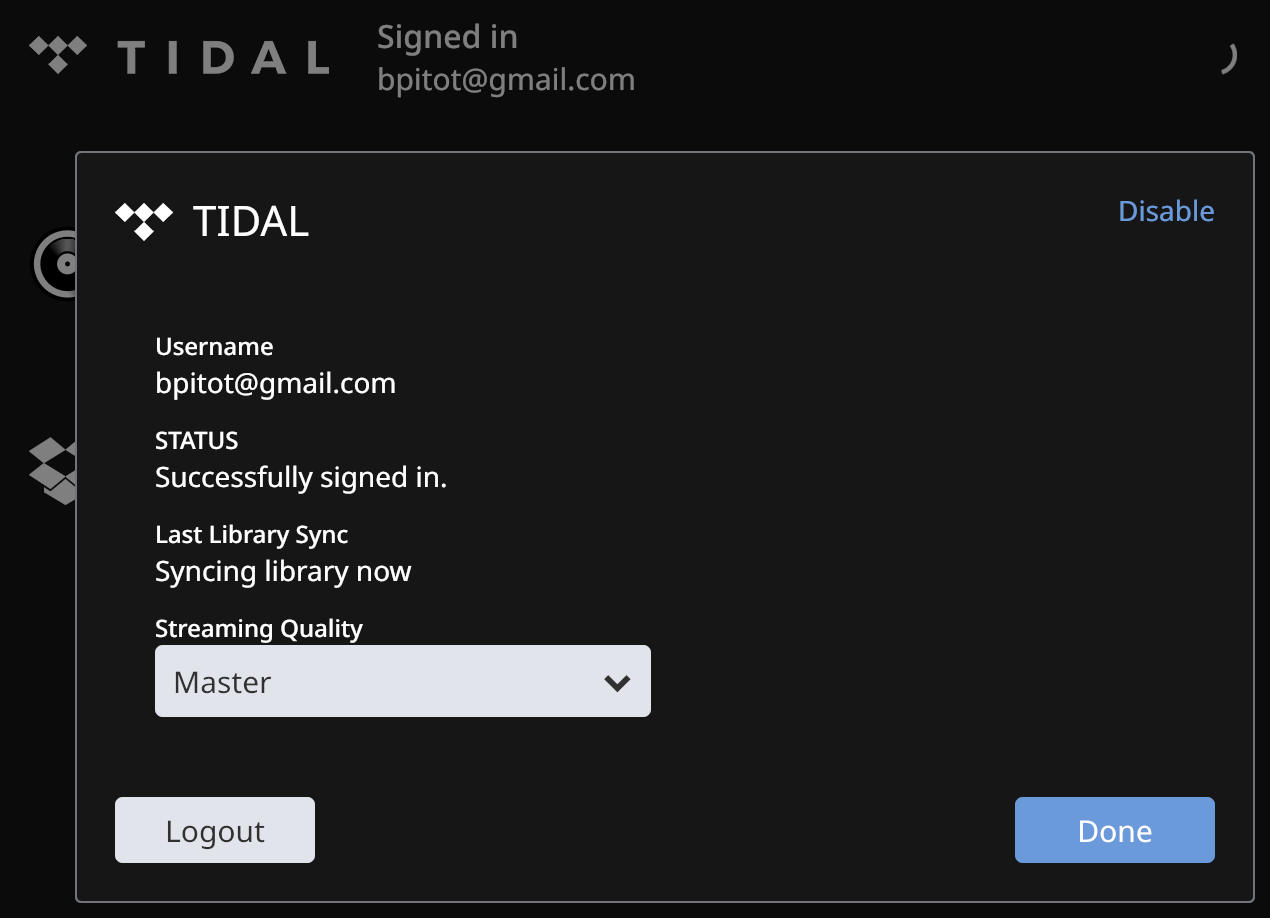

Updates: in Roon software, under Services menu, when I click on Tidal Edit button, I see “Syncing library now” under Last Library Sync… could this be the reason and why is it doing this? I am able to access just Tidal desktop and the music plays fine.
Updates 2: Logged out from Tidal in Roon > Services then logged back in and now I am able to listen to my tracks in Roon! FYI, in the Tidal Edit button there’s a “Sync Library Now” in blue color under Last Library Sync, not sure if you’re suppose to click on it, for now I won’t because I may still get the “Syncing library now” and unable to play my tracks again… anyway we need to find out what’s going on and how the synching process works, thanks!

Can you share a screenshot of the current sync status? Has there been an auto-sync since your last post?
Thanks Noris - just this morning I am experiencing the same issues… please refer to the screenshots below.
  1. What’s the syncing for?
  2. Can we disable this?
    Hope to hear from you soon, I can’t always log out and login from Tidal every time this happens.
Updates: signed out then signed backed into Tidal, here’s a screenshot:
Updates as of 6th April 2020 - I am seeing the same thing again and I am not able to listen to anything, screenshot provided below. I am now having to revert back to Tidal, I can’t continue to login and log out from Tidal everyday.
Updates as of 6th April 8pm (Singapore time) - logged out of Tidal then logged back in but still getting the same issue, unable to play any tracks. Checked and was able to access Nucleus Web Interface and decided to restart the Roon Server Software, after that the tracks are able to play. Could we please check what’s going on? Thank you.

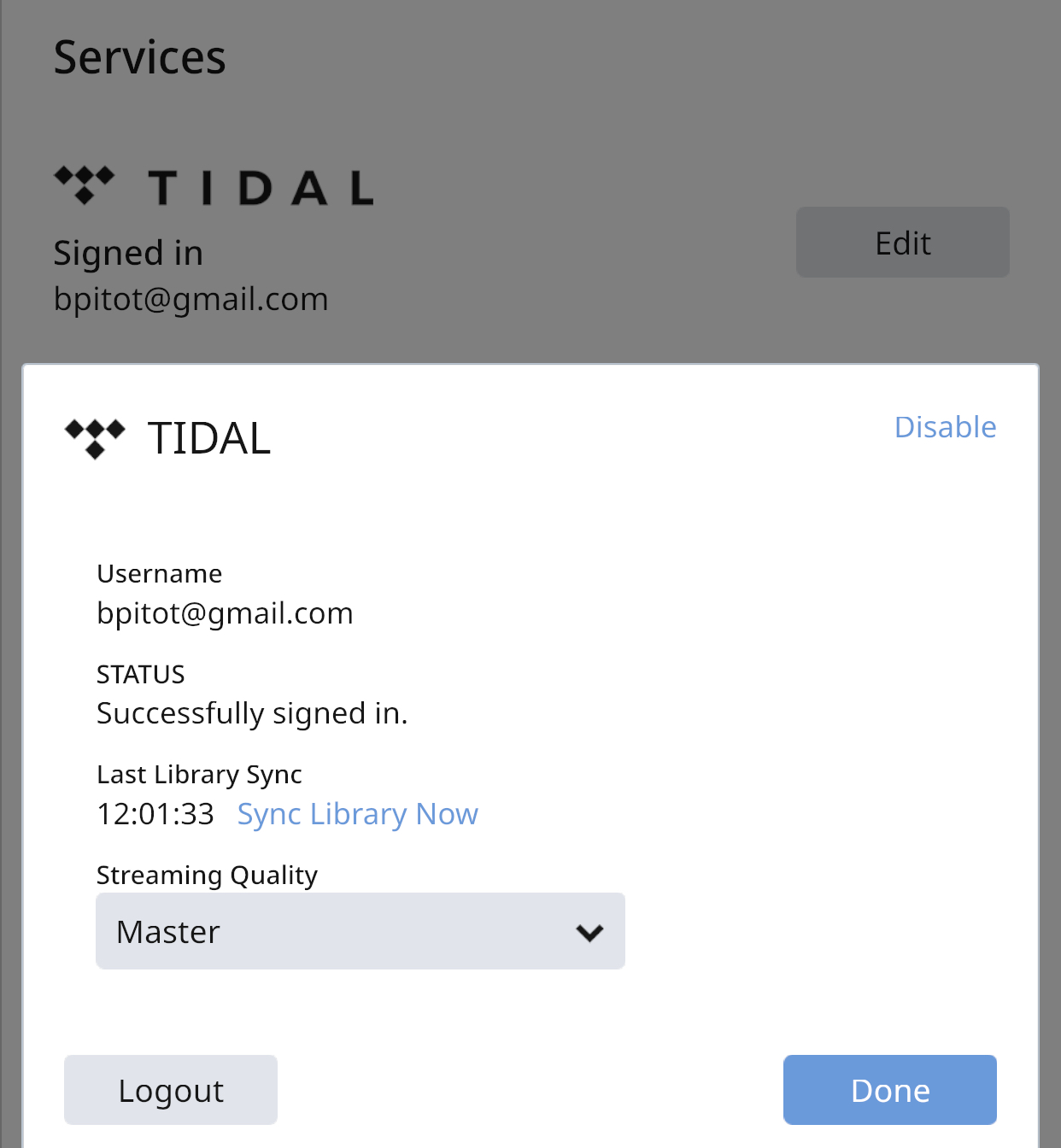

I have been on the lookout for the diagnostics report I mentioned and it doesn’t seem to be delivering properly to our diagnostics servers. Has this behavior re-occurred since your last message?
If it does can you please note the exact local time + date the issue occurs and manually send me a copy of your Roon logs by using these instructions? The best way to get them over to me would be via a shared Dropbox / Google Drive link, but if you don’t have either method, just let me know and we can discuss alternate upload methods.
Hi Noris - everything working as expected… here’s a screenshot, I’ll let you know if the issue reoccurs. Thanks!
