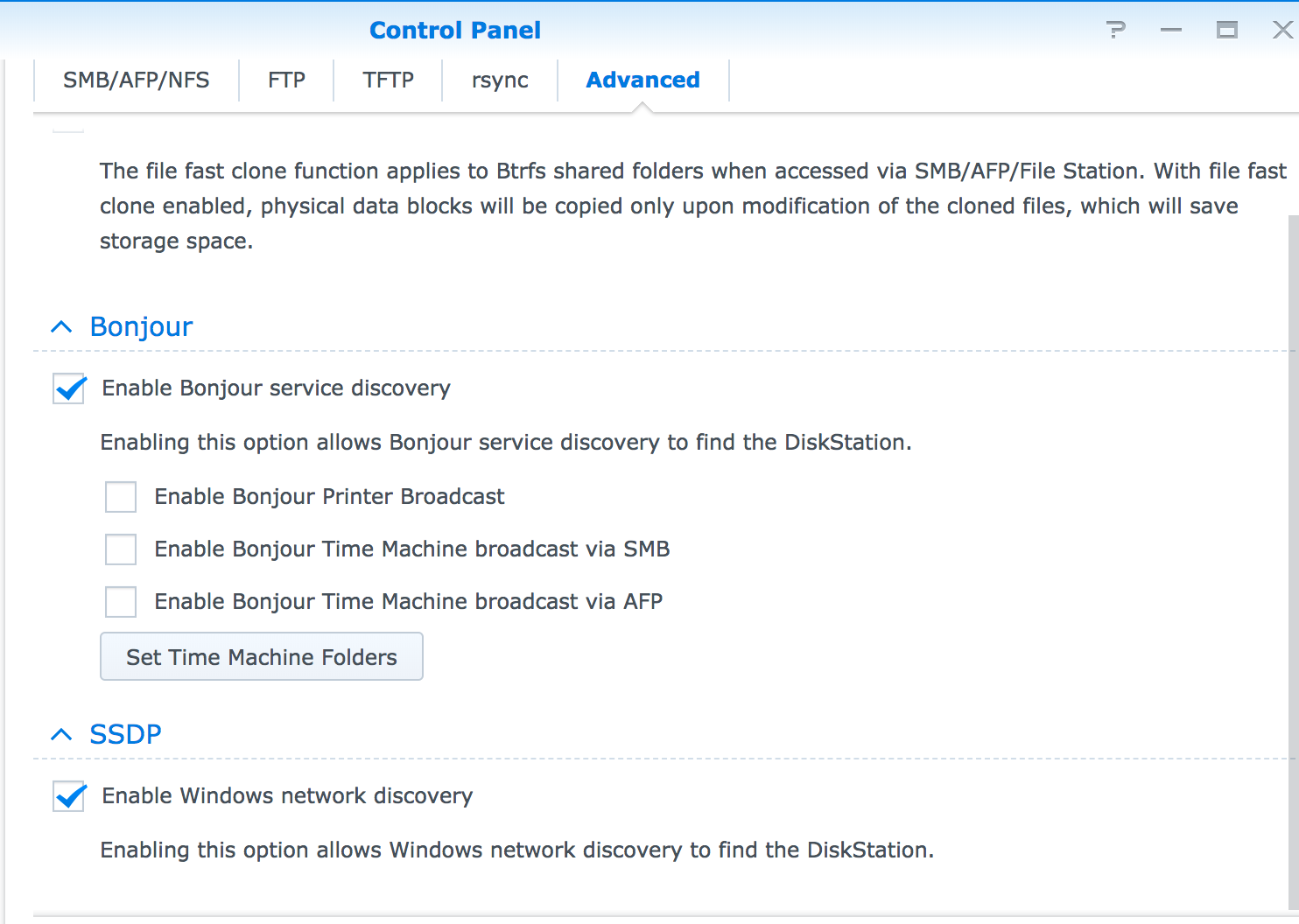

That seems to be an older version of the Synology control software. The new version doesn’t reference Windows File Service. Here are screencaps of what it does show
