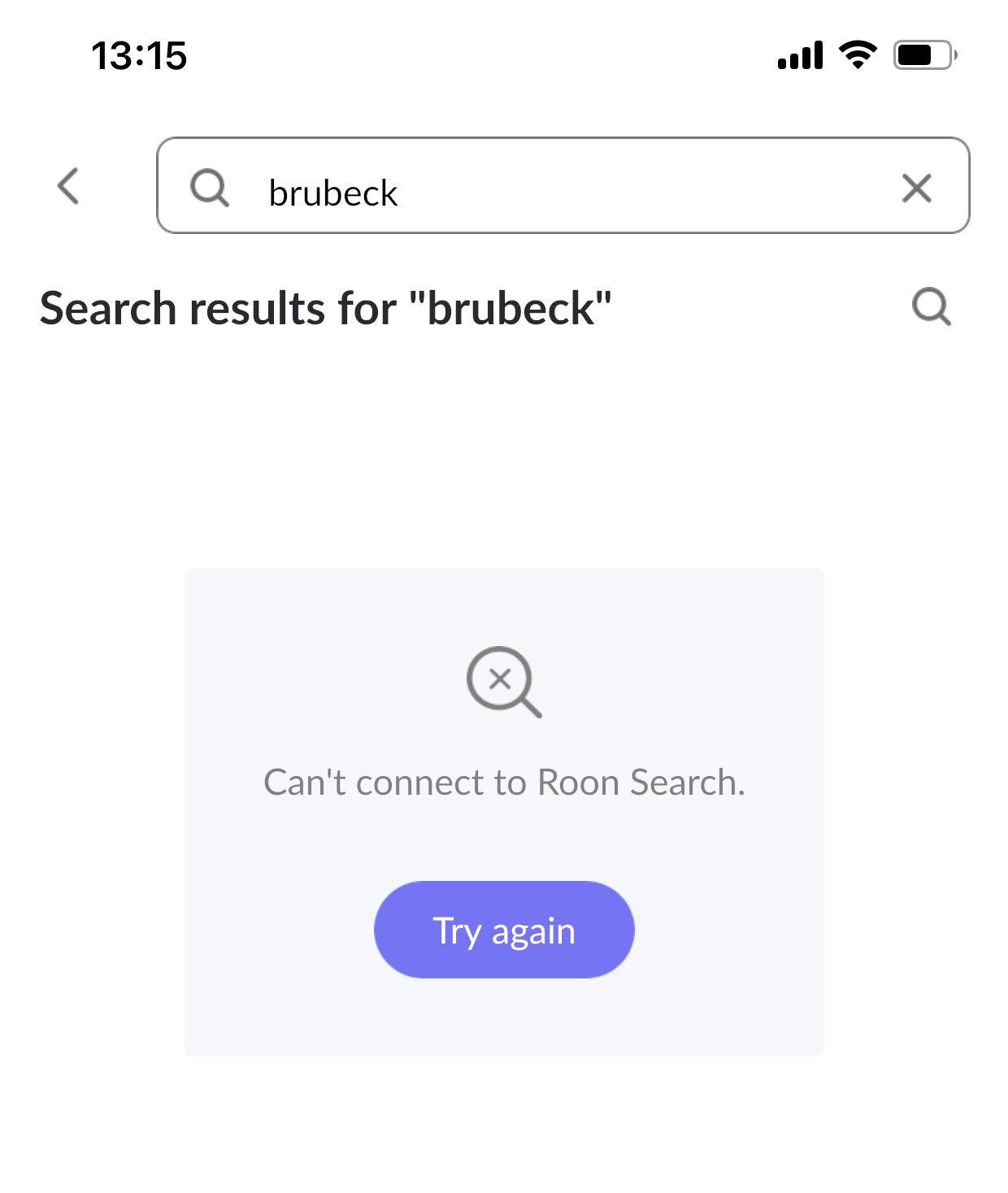

Issue: "Can't Connect to Roon Search" prompt appearing during search process (ref#VS1OPG)
Full form submission
I'm having trouble connecting to Roon
Something else
When searching Roon I get the prompt: "Can't connect to Roon Search". I have been using my config unchanged for 4 years and suddenly this appears.
